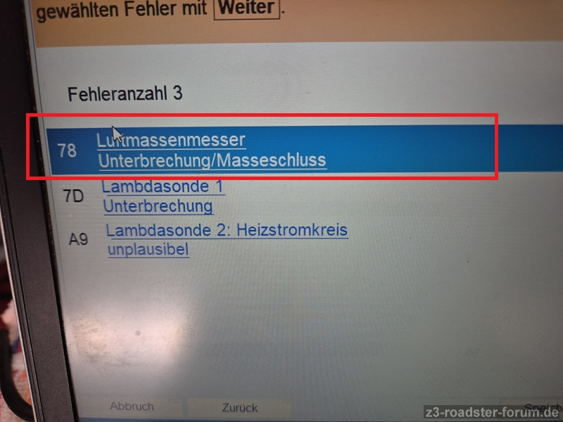

Beitragvon Zetti_sturi » Gestern 21:15
:wink:
