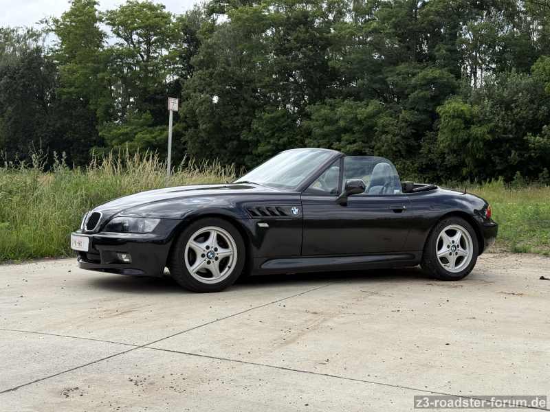

When looking for a Z3, I was well aware of the community consensus: buy a 6-
cylinder. However, I came across a clean Z3 1.9i in the Netherlands with a unique
history. It had been owned by a single family since the year 2000 and was
originally purchased directly from Kohl in Aachen the birthplace and parent
company of AC Schnitzer.
Standing at a crossroads, I decided to bypass the standard 6-cylinder advice and
take a leap of faith on this obscure 4-cylinder sleeper. Since I live in Belgium,
getting a modified car through our strict vehicle inspection (keuring) is a nightmare
without papers. This forced me to dig deep into the car's history to get it legally
road-registered.

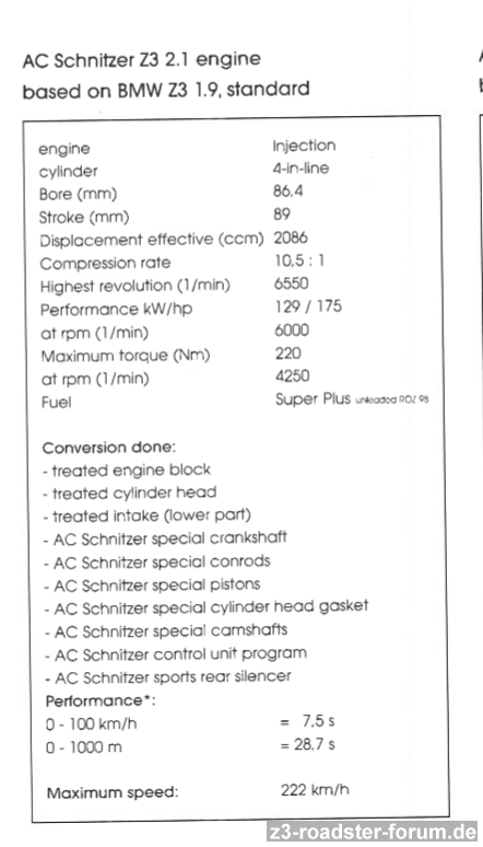

technische gegevens
Looking through the original 1996 AC Schnitzer catalogs I managed to source, the
pricing of this build explains why it is so incredibly rare. In 1996, a base Z3 1.9i cost
around DM 43,800 (Deutsche Mark).
The original owner piled on the following upgrades at Kohl before delivery:
Schnitzer Motorworks 2.1L Engine Kit (including sports exhaust): DM 12,900
AC Schnitzer Bespoke Suspension (Billstein dampers and Eibach springs): DM 1,960
This brought the total price to nearly DM 59,000. To put that into perspective: a
brand new Z3 2.8L 6-cylinder cost DM 55,900 at the time.
The original owneractively chose to spend more money on a hand-built 4-cylinder stroker from a
racing division than it would have cost to buy BMW’s top-tier 6-cylinder.

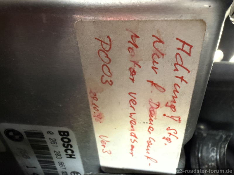

28 October 1996: ECU calibrated at Kohl/AC Schnitzer in Aachen. A handwritten sticker in red ink was applied reading: Haltung! Stg. Neu f. Doppelvergaser Motor verwandtschaft — Vers 3 — PO03.

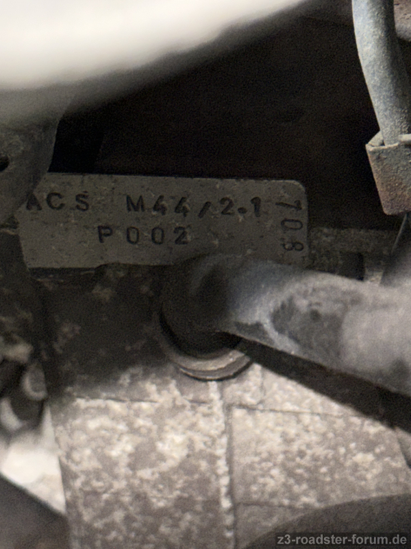

November 1996: TÜV Rheinland officially approves the M44 ACS21 2.1 conversion. The engine block is stamped: ACS M44/2.1 — P002 — 708.

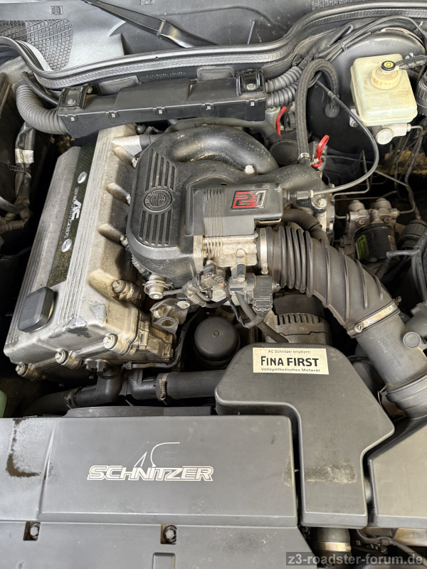

engine

What sealed the deal were the internal engineering stamps. The engine block is
stamped with P002, and the ECU is marked with P003. These refer to the original
hand-built production/prototype sequence numbers from the internal Schnitzer
Motorworks development program. Based on this, he confirmed the conversion's
authenticity and provided the necessary TÜV certificates, allowing the car to pass
the Belgian inspection flawlessly.
ECU

From a technical standpoint, this was a core mechanical stroker kit built by
Schnitzer Motorworks (the engine building branch tied to the Schnitzer
Motorsport racing division in Freilassing), rather than the usual AC Schnitzer
aesthetic parts catalog.
I have the original technical datasheet from Schnitzer outlining the internal
modifications (pistons, crankshaft, head work, and camshafts). Together with the
remapped ECU and the integrated sports exhaust system, the output is 175 hp.
Period German and French magazines from '96 and '97 noted a 0-100 km/h time
just under 7 seconds.
To my ears, the integrated AC Schnitzer exhaust completely changes the character
of the M44; it gives it a deep, aggressive tone that is, in my personal driving
experience, even more engaging than a standard factory 6-cylinder exhaust note,
while retaining the lightweight nose and 50/50 balance of the 4-cylinder chassis.

While AC Schnitzer recognized these stamps as official internal Schnitzer
Motorworks codes, I am still searching for their exact breakdown. If anyone here
has deep connections to early Schnitzer Motorsport engineering or has ever seen
these P002 and P003 codes before or someone has more information about this above, please let me know.
