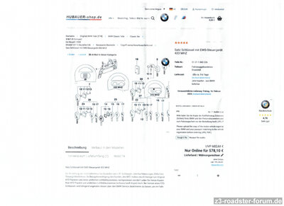

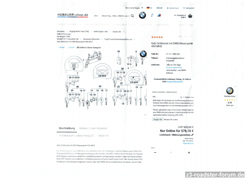

Hello, I'm writing to you from Italy, I have a 1999 BMW Z3 2.8 and I need to buy a new remote control key (433 MHZ, right?). I contacted 2 different BMW workshops and they told me that it can no longer be ordered. I saw on HUBAUER that a set was available that includes the remote control key I need, code 51 21 1 000 226. Is this the correct code? I said "It was available" because it was until last Wednesday afternoon... Now the link is no longer valid https://www.hubauer-shop.de/de/satz-sch ... 00226.html
Is it sold out just now that I needed it, after 25 years? I had also printed the corresponding page which I attach. I only know HUBAUER, can anyone suggest where I can find it alternatively? Thank you

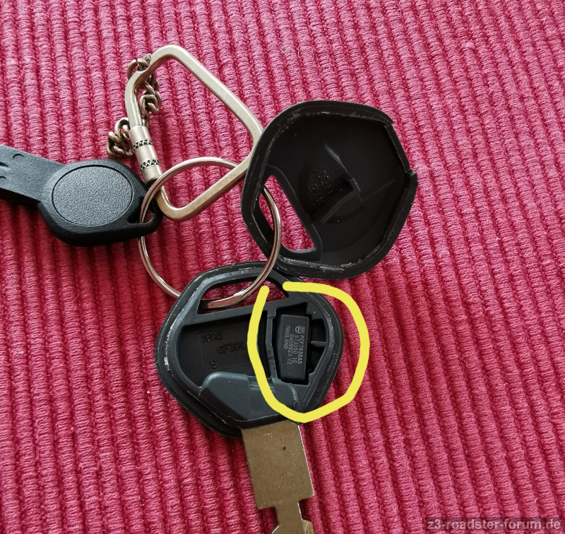

Beitragvon OldsCool » 11.02.2024 01:51
That's the easiest task... The normal key pops open with a blade, the transponder is picked out and placed in the new key, which opens with screws (like battery change)
Beiträge: 7683
Registriert: 05.06.2019 14:08
Re: Purchase new 433Mhz remote control key
Beitragvon OldsCool » 11.02.2024 02:58
Here's a picture:
