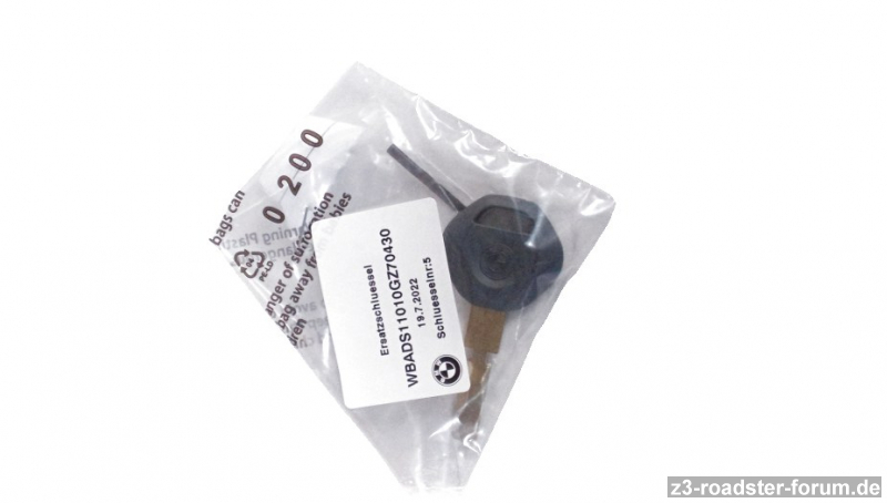

OldsCool hat geschrieben:Here's a picture:
Just to be sure: so is this the cheapest key I can buy in BMW? What is the spare part number? Or are there even cheaper keys than this one? Considering that I only need the key to open it and get the transponder. Thank you
Miky2147
Alter: 30
Beiträge: 18
Themen: 3
Registriert: 09.02.2024 19:52
Wohnort: Macerata, Italy
Z3 roadster 2.8 (07/1999)
Re: Purchase new 433Mhz remote control key
Beitragvon OldsCool » 20.02.2024 21:02
It's not about the cheapest key, but the only one which might be still available. You need to check with your dealer. If no key at all is available, the only option is to reprogram the Immobilizer/EWS with a blank transponder (delivered with the ebay key).

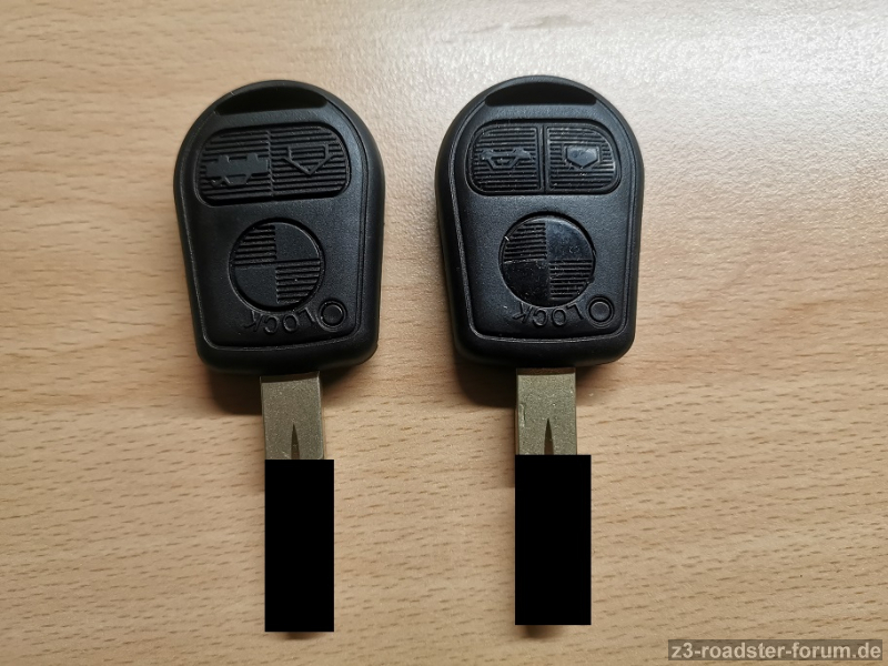

Beitragvon OldsCool » 20.02.2024 21:32
Just two screws, like battery change. The Z3 keys are very dismantle-friendly :)

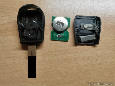

Here are the pictures:

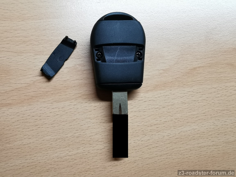

Remove Cover of the screws:

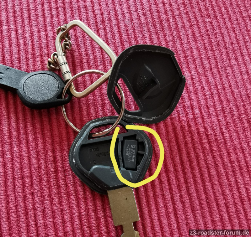

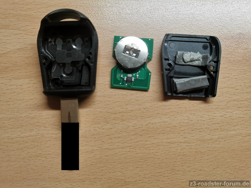

Remove Screws with a small Phillips-driver and take off cover and electronics (it's the ebay version in the picture). Transponder is in lower right corner of the key housing (left), fixed with a drop of instant glue just not to move around:

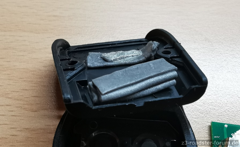

Some spacing material to get the electronics close and firm towards the buttons. I used double-sided sticky tape out of thin foam and different number of layers to achieve the best necessary button push force so that it can be pressed easily, but doesn't lock/unlock the car on the lightest touch:
Comparison between ebay key as is (left, more like hard plastics buttons) and modified ebay key with spare buttons mat also from ebay (right, more like flexible rubber buttons), meant for the OEM key.
