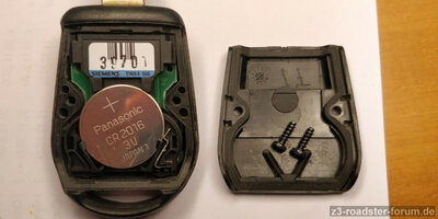

Zusätzliche Schlüssel Z3
But you don't have to buy the Key at the BMW Dealership.
You can buy your Key Here
https://www.ebay.de/itm/224184134835
You send the Dealer a picture of your current Key, and he creates you a new Key.
With this Key, you can open every Lock Cylinder except the Trunk.
The Trunk Lock cylinder don't work.
For your Wireless Open an Close you have to use a certain order in your Car.
1. open the door (if necessary, unlock it manually)
2. close the door
3. switch on the ignition
4. switch off the ignition
5. remove the key
6. Press and hold the left button
7. Press the middle button three times
8. release both buttons
9. The Car Show you the right programming. It will Close and Open one time.
Electronic immobilizer
You have to programming the electronic Immobilizer.
How to do it, you can read Here.
Re: Wir erstellen Reparaturanleitungen - wer macht mit?
There is a PDF File and also an additional note and good Tip from the USER @oldscool
Have a good and Sunny day in Italy and good weather to Drive your "Zetti"
Many Greats
Mikelgrey

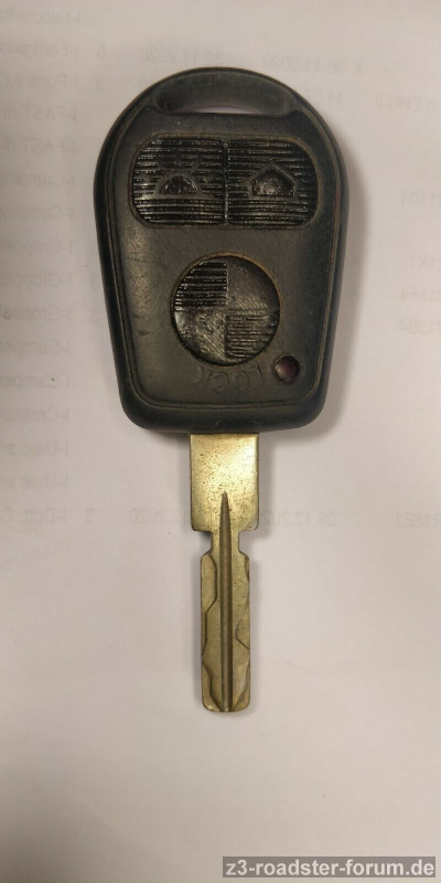

Yes, link is confirmed. The web shown in the pictures is a E46/Z4 type. But no worries, based on the picture of the key you send in, you will get the correct key web. Z3 is technically a E36 which is listed, and the remote is all the same (works on E46/Z4 as well).
Did it for 4 keys for both my Z3.
Best regards,
Steffen

Ok in my case I'm thinking of not having the seller mill the key because I would prefer to have it done by the BMW workshop. I think the milling from the BMW workshop will be more precise than the milling the seller will get based on the photos. What do you think?

The BMW Dealer cannot mill you anything. He just orders the keys from factory/supplier.
Based on your picture, your key will be decoded. With the key code, the key is milled on a professional machine. It's not a copy of your potentially worn-out key like on a profiling machine, but a brand new key with sharp edges based on the code.
No worries... The only difference to the OEM key is that the angle of the milling at the tip is not 100% similar. It's not an issue on the door and ignition lock, just won't fit right away on the trunk lock (2 min of filing and it's fine). This is a very acceptable trade-off for 1/10th of the OEM pricing :wink:
I don't want to publicly post my keys here to show you, but Mikel did in the post linked already. Also you can find comparison pictures here. This is the master thread about keys and reveals all details and our In-depth experiences. Google translate will help you understand the written, but the pictures tell much.

Hello, I ordered the replacement key from the "e-bacho" seller you suggested. I'll let you know when it arrives. In the meantime, I found a person who can sell this key which was from a 1997 E36 SERIE 3 320ì TOURING. I would like to ask if anyone can tell me if it would be possible to use this remote with my 1999 Z3. It's compatible? Is it 433Mhz? Would it be possible to use the remote control of this one and transfer the milled key that I will receive from the eBay seller "e-bacho" to it? Or would there be any other way? Thank you

Yes I know the ebay key will come with the working remote. I am evaluating this additional key for the sole purpose of having an original OEM remote control key, if the possibility exists. What I would like to know is: if I buy that key, will I be able to use it with my Z3? To use it I will have to change the "blade" of the key (is this possible or is it a single non-removable block?) and put another transponder from another original key, right? While to program the remote control will I have to do the same procedure indicated for the replica sold on eBay? Thank you
