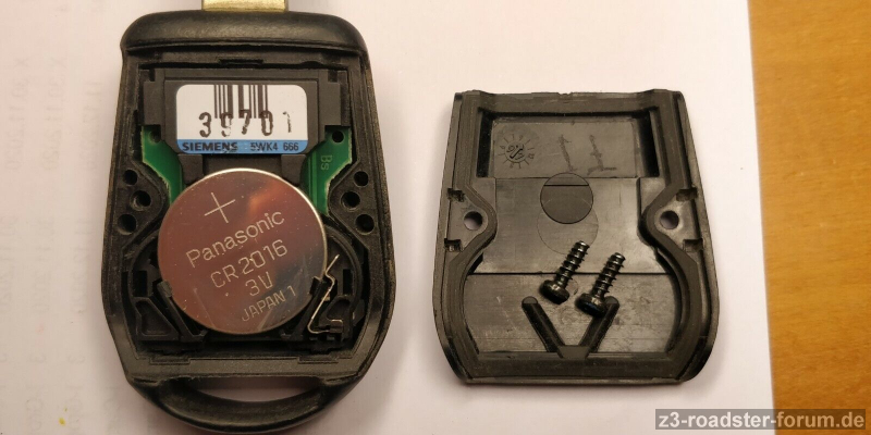

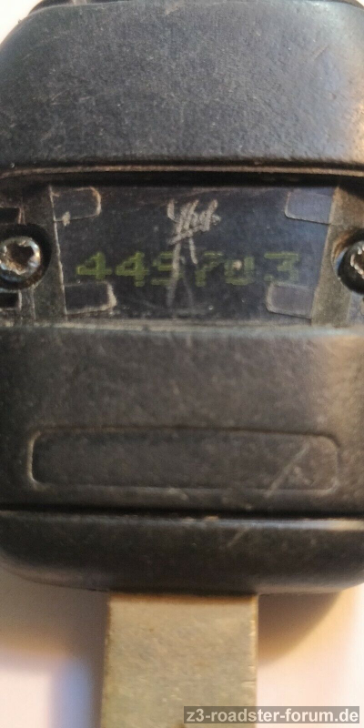

Hello, I ordered the replacement key from the "e-bacho" seller you suggested. I'll let you know when it arrives. In the meantime, I found a person who can sell this key which was from a 1997 E36 SERIE 3 320ì TOURING. I would like to ask if anyone can tell me if it would be possible to use this remote with my 1999 Z3. It's compatible? Is it 433Mhz? Would it be possible to use the remote control of this one and transfer the milled key that I will receive from the eBay seller "e-bacho" to it? Or would there be any other way? Thank you

Yes, this should be compatible. But the key from ebay should come with a remote as well if you took the one in the link for 25€. No further parts necessary.

Yes I know the ebay key will come with the working remote. I am evaluating this additional key for the sole purpose of having an original OEM remote control key, if the possibility exists. What I would like to know is: if I buy that key, will I be able to use it with my Z3? To use it I will have to change the "blade" of the key (is this possible or is it a single non-removable block?) and put another transponder from another original key, right? While to program the remote control will I have to do the same procedure indicated for the replica sold on eBay? Thank you
